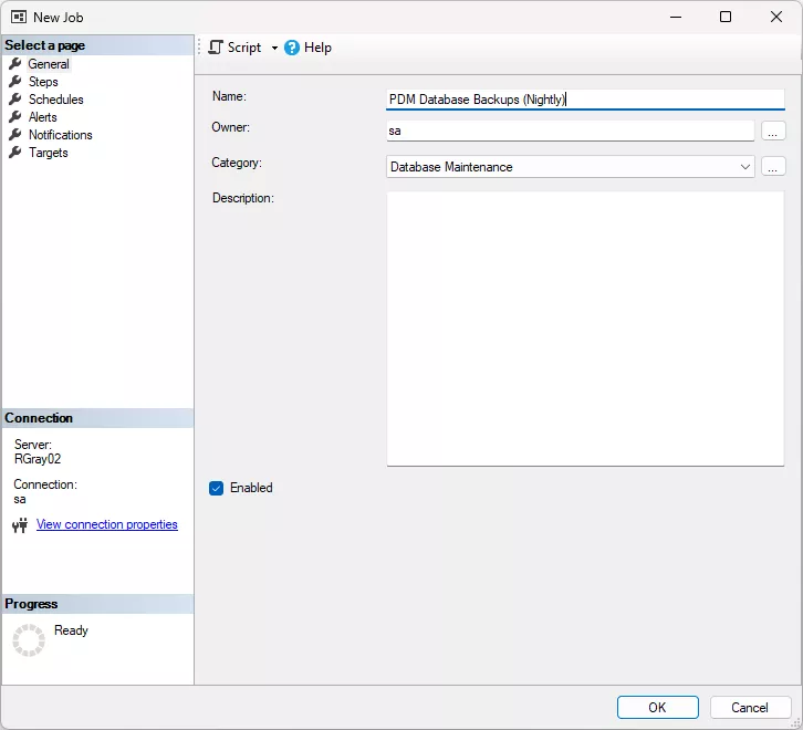

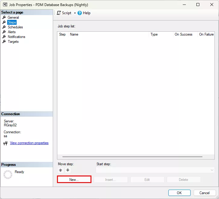

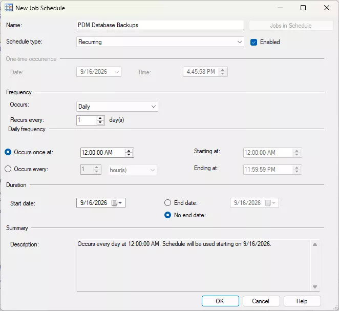

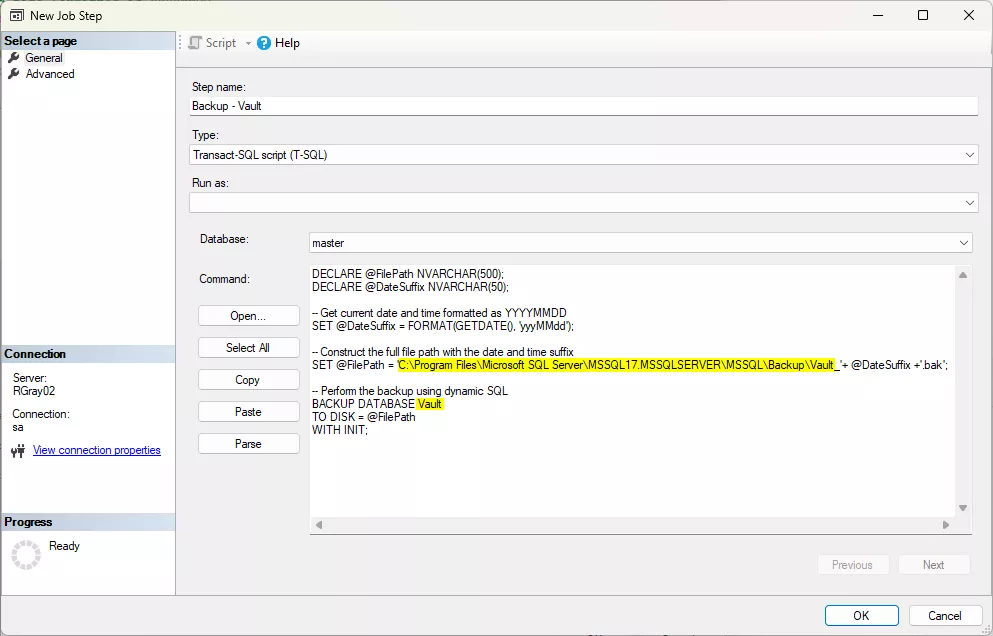

Creating a Backup Plan
- Walk through the above steps for using the Maintenance Plan Wizard. Set the schedule to daily backups for the best possible chance of recovery.
- On the Select Maintenance Tasks page, choose Back up Database (Full) and Maintenance Cleanup Task. Then, click Next.
- On the Task Order page, ensure that the Back Up comes first, and the Cleanup Task is second. Then, click Next.
- Define the Back Up Database (Full) Task.
- General Tab
- Choose All Databases from the dropdown menu.
- Choose to back up to Disk. Then, click Next.
- Destination Tab
- Select Create a backup for every database.
- Choose a directory to put the backups in or leave it as the default.
- Ensure the extension chosen is bak and then click Next.
- Define the Maintenance Cleanup Task:
- For Delete files of the following type, choose Backup files.
- For File Name, choose to Search folder and delete files based on an extension.
- Make sure to put the extension of bak.
- For File Age, select the box for Delete files based on the age of the file at task run time.
- Choose how long you’d like to keep backup files for, and then click Next.
- Select Report Options:
- Select the box for Write a report to a text file.
- Choose a location to store this file. Then, click Next.
- Complete the Wizard by clicking Finish.

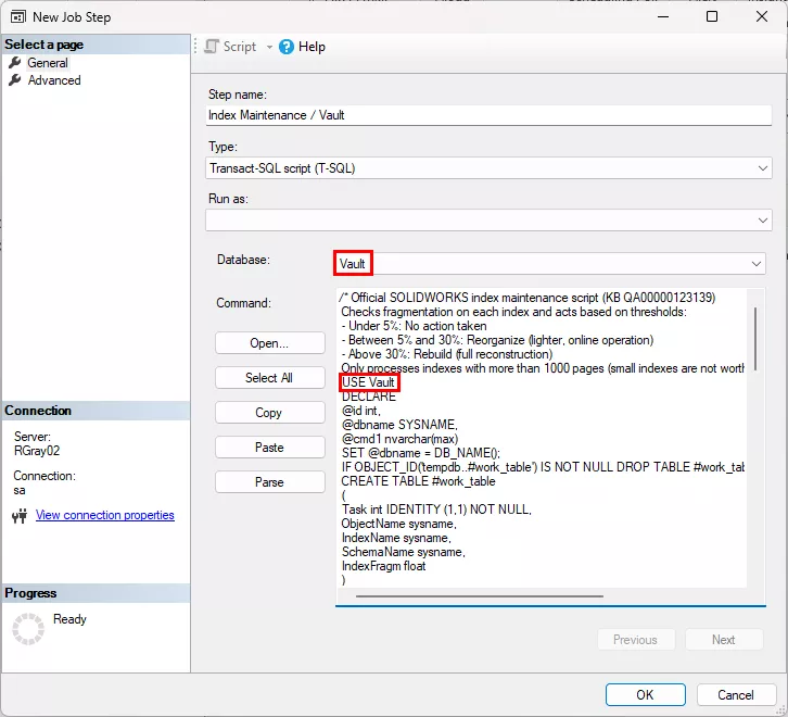

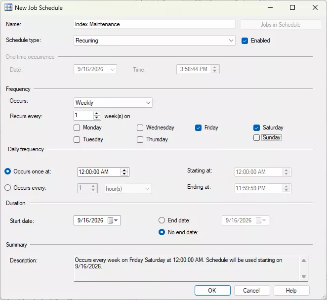

Creating a Reorganize and Rebuild Plan
Tables in the Vault Database contain indexes, which ensure efficient lookups. This is automatically maintained by the SQL Server, whenever an insert, update, or delete type change is made in the underlying data. Over time, due to growth, indexes get a bit fragmented. Updating and refreshing the indexes will help with the more severely fragmented instances. In turn, the maintenance plan will improve performance for searching, browsing, and other interactions with the File Vault.
- Walk through the above steps for using the Maintenance Plan Wizard. Set the schedule to once a week to maintain a healthy vault.
- On the Select Maintenance Tasks page, choose Reorganize Index and Rebuild Index. Then, click Next.
- On the Task Order page, ensure that the Reorganize Task comes first and the Rebuild Task is second. Then, click Next.
- Define the Reorganize Index Task:
- Choose All Databases from the dropdown menu. Then, click Next.
- Define the Rebuild Index Task:
